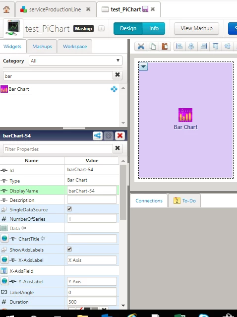

I have Custom Chart Widgets, and trying to display bar chart but I don't know what property do i need to configure for this.

Best answer by mneumann
This here is a step-by-step example which should work fine.
Maybe you missed one of the mappings or steps.
  1. Create a new Thing "DataProviderThing" with an InfoTable property "DataProperty"
    • For the InfoTable use a new DataShape "DataProviderDataShape", with e.g. the id, value1 (numeric), value2 (numeric)
  2. Save the DataProviderThing
  3. Edit it's InfoTable, e.g. (id = 1, value1 = 11, value2 = 110) (id = 2, value1 = 12, value2 = 120) (id = 3, value1 = 13, value2 = 130) and save it
  4. Create a new Mashup with a BarChart
  5. Add the DataProviderThing's "GetPropertyValues" service and check it's executed on "Mashup Loaded?" (checkbox when adding the service)
  6. Map the GetPropertyValues' "All Data > DataProperty" to the BarChart's "Data" property
  7. Properties for the Bar Chart to change:
    • NumberOfSeries = 2
    • X-Axis-Field = id
    • DataField1 = value1
    • DataField2 = value2
  8. Save and "View Mashup" - there should be 3 x-Axis entries with 2 data columns each, showing the values defined in the InfoTable previously

You need to bind an InfoTable to the Bar Chart's DATA input for displaying any data.

Thanks for the reply. Yes i did the same but still bar chart not displayed could you please share property window screen. because I thing i miss some configuration over there. here i attached output screen.
July 20, 2018
You also have to select the X-axis and Data Fields in the properties.
