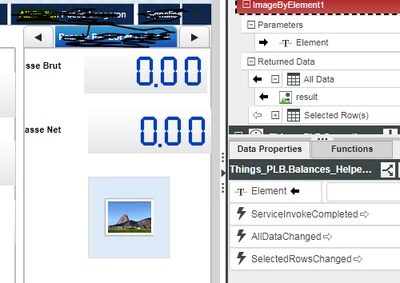

I'm trying to upload images that figures in my repository in order to visualise them in a mashup,

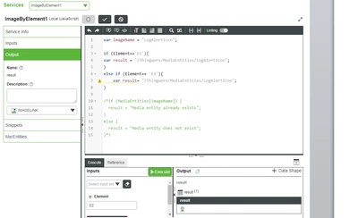

First I created a simple service for this that return image link based on selected items in a list which are Strings (E1,E2,E3,....) but I figured out that it's not that simple because I can not bind the image doesn't change in my mashup.
Actually I need to visualise images that exists in my repository but I don't find the file.
Now I don't understand why I don't get the image from my file

    GetFileListingWithLinks should get you the link to the image files in your repository
    the Image widget should allow you to bind dynamically a link to it.
    You could potentially try the value display widget as well, but I believe Image widget is the correct one.

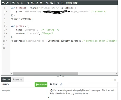

    Thanks for your answer I actually tried your recommandation but the problem is that I don't find GetFileListingWithLinks service in generic services ? is it a service that exist already in thingworx by default like getdatatableentries for example ?
    Also I want to know if I need to specify the path that exist in my disc computer or the path of repository ?
    path : 'TPM.Repositoy/tpm.plb/PALES/PP_355/Images_Elements'
    or path : C://ProgrameFiles.... which I don't find by the way 😕
