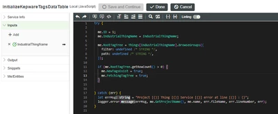

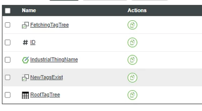

The properties used:

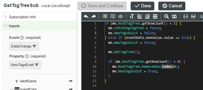

The subscription:
The service used to trigger the subscription to start:

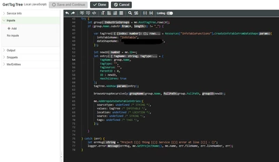

The service that is run by the subscription. This doesn't show the recursive part, but basically it is just going over each level of the "root" node.
The subscription:
