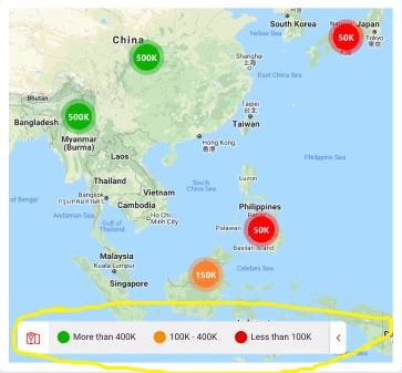

Hi, Currently I used the google map widget to display some data with different color representations, Now I have to add legends for that colors.
Is there any way in thingworx to use one widget above another widget using CSS or Z-index ???
Please take a look at this UX for better clarity....
Like in this design,  I need to display legends on top of the google map widget...

Hi @sabharees
I don't think there is any property present in ThingWorx through which you can display legends on top of the google map widget
But, you can do customization over the Google map widget to display legends on top of the google map widget
Please check this link and see if it helps you with your use case
