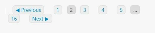

Hi ,
I have 16 pages and it displays 1 to 5 and then the 16th page no. on my screen.But I want to display only two nos and the next and previous button .I can do that for two pages,how do I do it when I have 16 pages?
for eg: I want " previous 5, 6,next "
instead of   "previous 1,2,3,4,5 ...16,next .
please check images for better understanding.
@pagination.JPG   This is what i want when i have 16 pages
16pagination.JPG but this is how it displays

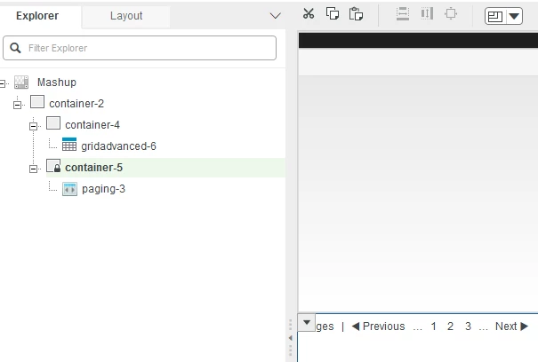

Best answer by TravisPickett
You will have to write some custom CSS to modify what is displayed for the paging widget.  Since there is not a custom CSS property for the paging widget you will have to specify the custom class on a parent container.  For the following code I put the custom class on the parent container
  1. Create a Custom Class ( hideExtraPages )
  2. Custom CSS

Sample Composer View: ( hideExtraPages is set on Container-5)
Sample Mashup View:
  2. Custom CSS
Sample Mashup View:
