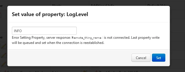

Thingworx Composer displays error message when trying to set property from Thing's properties.Looking to implement  a similiar functionality from thingworx dashboard.

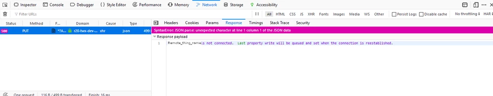

Also I am trying to call another service on SetPropertyValues service's ServiceInvokeCompleted event, which is not getting fired if SetPropertyValues fails(with 500 status code).
