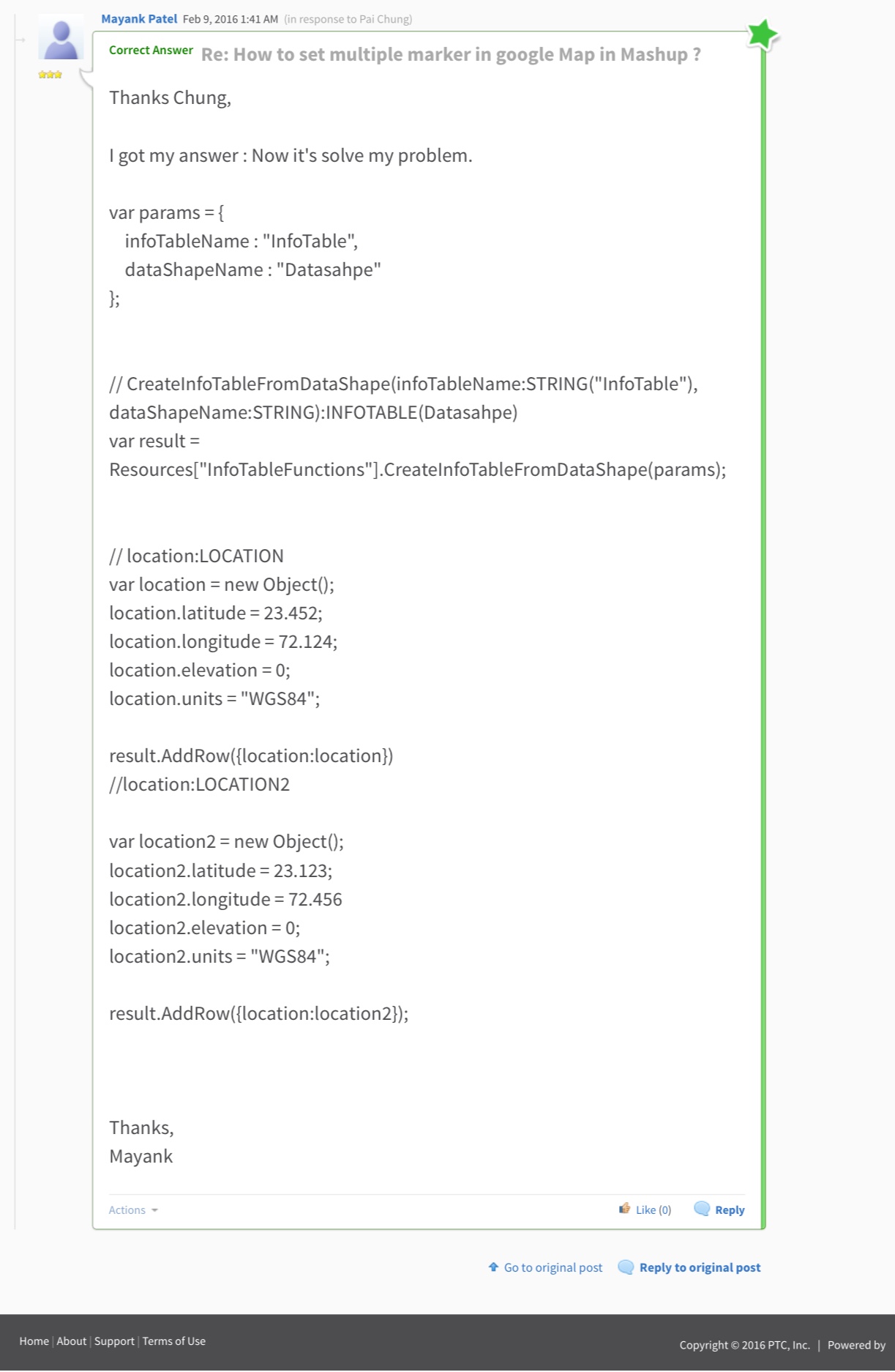

sreddy-211-VisitorAuthor
Oct 28, 2016 10:52 PM UTC
i am following your source code, as shown in the screen shot
As it is not very straight forward I couldn't understand how to use it
Oct 29, 2016 12:13 AM UTC
Hello Mayank
I have tried this
1. i created a thing , declared a property called loc with location property
2. i created service
and created a infotable with the help of ur scource code as shown below
var params = {
  infoTableName : "InfoTable",
  dataShapeName : "DataShape"
// CreateInfoTableFromDataShape(infoTableName:STRING("InfoTable"), dataShapeName:STRING):INFOTABLE(DataShape)
var result = Resources["InfoTableFunctions"].CreateInfoTableFromDataShape(params);
// location:LOCATION
var location = new Object();
location.latitude = 23.452;
location.longitude = 72.124;
location.elevation = 0;
location.units = "WGS84";
result.AddRow({location:location});
//location:LOCATION2
var location2 = new Object();
location2.latitude = 23.123;
location2.longitude = 72.456
location2.elevation = 0;
location2.units = "WGS84";
result.AddRow({location:location2});  // You can Add multiple marker using Add row.
But when i tried to test the service the output is empty
22-Sapphire I
Oct 31, 2016 11:51 AM UTC
Did you set your Service Output to InfoTable and then I also advice you assign the Proper DataShape to it as well.
btw since this is a platform there are quite a few ways to accomplish this.
One thought is to have a Thing per country all based on the same ThingTemplate and then you can add other properties/meta data including the location
then you can use GetImplementingThingsWithData to get the Countries, their locations and other information to use all at once.
