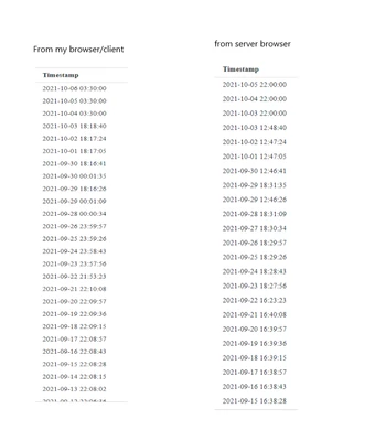

PaiChungAnswer
22-Sapphire I
October 12, 2021
Timestamps are maintained in UTC and automatically converted to browser local time.
So if you need to force it to a different time zone you can probably go a few routes
1. Maintain an offset and apply that offset to the datetime before sending it to the client machine
2. Generate the list on the server and then convert it to string so it is string vs. time date in the client machine
3. Use an expression client side to offset the datetime before displaying
PaiChung22-Sapphire IAnswer
22-Sapphire I
October 12, 2021
