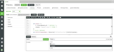

How to filter the info table with the combination of two columns in info table. In distinct snippet, I am able to give only one column name. But I want to filter the info table with the combination of two columns. How to do that?

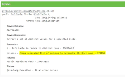

@AP_9587236  I think you can give multiple columns separated by comma

I have provided 2 column names in distinct snippet but only one column showing in result infotable.

Hi @AP_9587236.
Try removing the space after the comma.
Regards.
