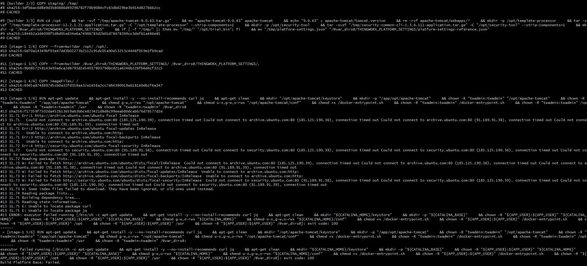

Docker install Build Postgres DB: Failed.
I am trying to build image of thingworx 9.1 on docker.
this is the tuto i am folowing:
https://support.ptc.com/help/thingworx/platform/r9/en/index.html?_gl=1*76uyjh*_ga*MTQyMTY0MzUwOS4xNjczMjU5Mjcz*_ga_1QBT6P6HR1*MTY3Nzg2NDM4My40OC4xLjE2Nzc4NjQ0NzEuMC4wLjA.#page/ThingWorx/Help/Installation/ThingWorxDockerGuide/thingworx_docker_getting_started.html#
failed to compute cache key: "/staging/Thingworx-Platform-Postgres-9-1-14.zip" not found: not found
More detail on attached file.
Any idea to resolve this is welcome.
Thank you
Mar 7, 2023 1:08 PM UTC
Resolved.
It seems to be a dns issue.
I put 8.8.8.8 DNS and it worked.

Mar 6, 2023 5:44 PM UTC
Thank you for your answer.
I already have those files on my staging folder.
I restarted my docker and the error disappear.
Now i have another error  :
#13 31.71 Err:2 http://archive.ubuntu.com/ubuntu focal-updates InRelease
#13 31.71 Unable to connect to archive.ubuntu.com:http:
#13 31.71 Err:3 http://archive.ubuntu.com/ubuntu focal-backports InRelease
see attached file.
Thank you
18-Opal
Mar 7, 2023 8:22 AM UTC
Looks like a network issue. Try to turn off your system firewall temporarily and see if it helps. Make sure you are not behind a proxy, not on VPN, etc.
