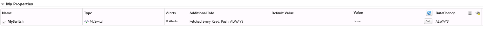

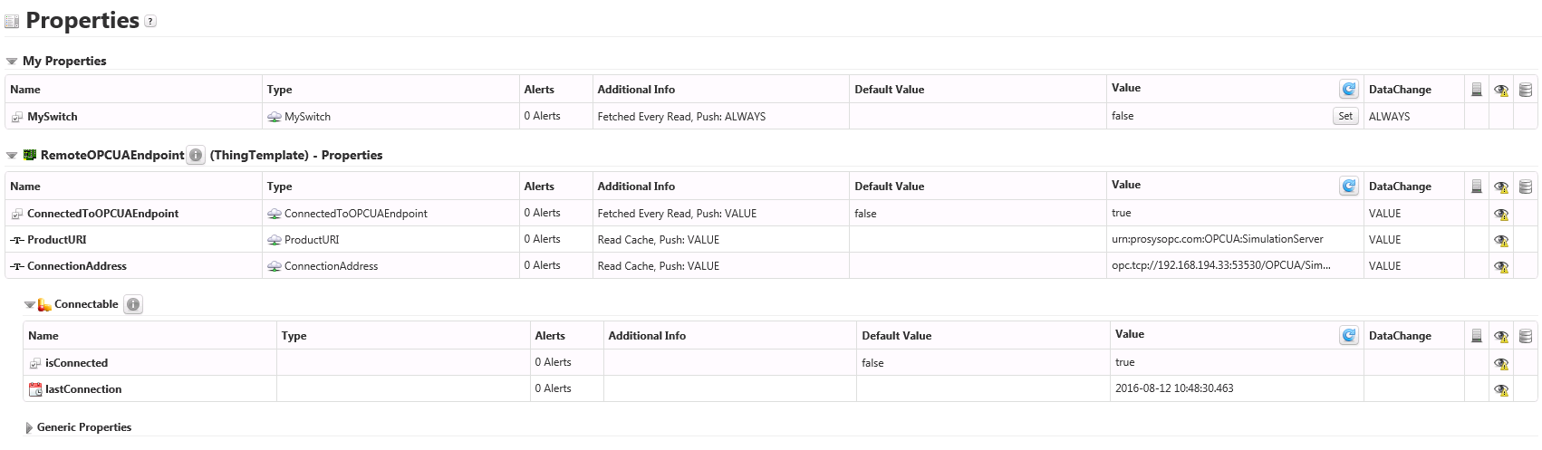

Now i am trying to change the value of MySwitch from the Properties tab of the thing, but this doesn't work:

Lyutskan, does it time out in the platform when you set the property value?
August 15, 2016
Hi Aanjan,
no, there is no timeout, no error message. The new value is set and shown briefly under Value. After few seconds or refresh the old value is back again. In the logs on the sever side is nothing to find, that the Value change has been initiated.
If the OPC UA Client is shutdown there is an error message, that the connection is not available, as expected.
Thank you for your help.
August 15, 2016
Is a value from the OPC server getting pushed constantly to the platform? It looks like you are setting a value in the platform, which goes to your server, but the OPC server is overriding/ sending back values that get written once again the platform. I would imagine that's why you see the values you set until the next push (5 seconds?) occurs.
