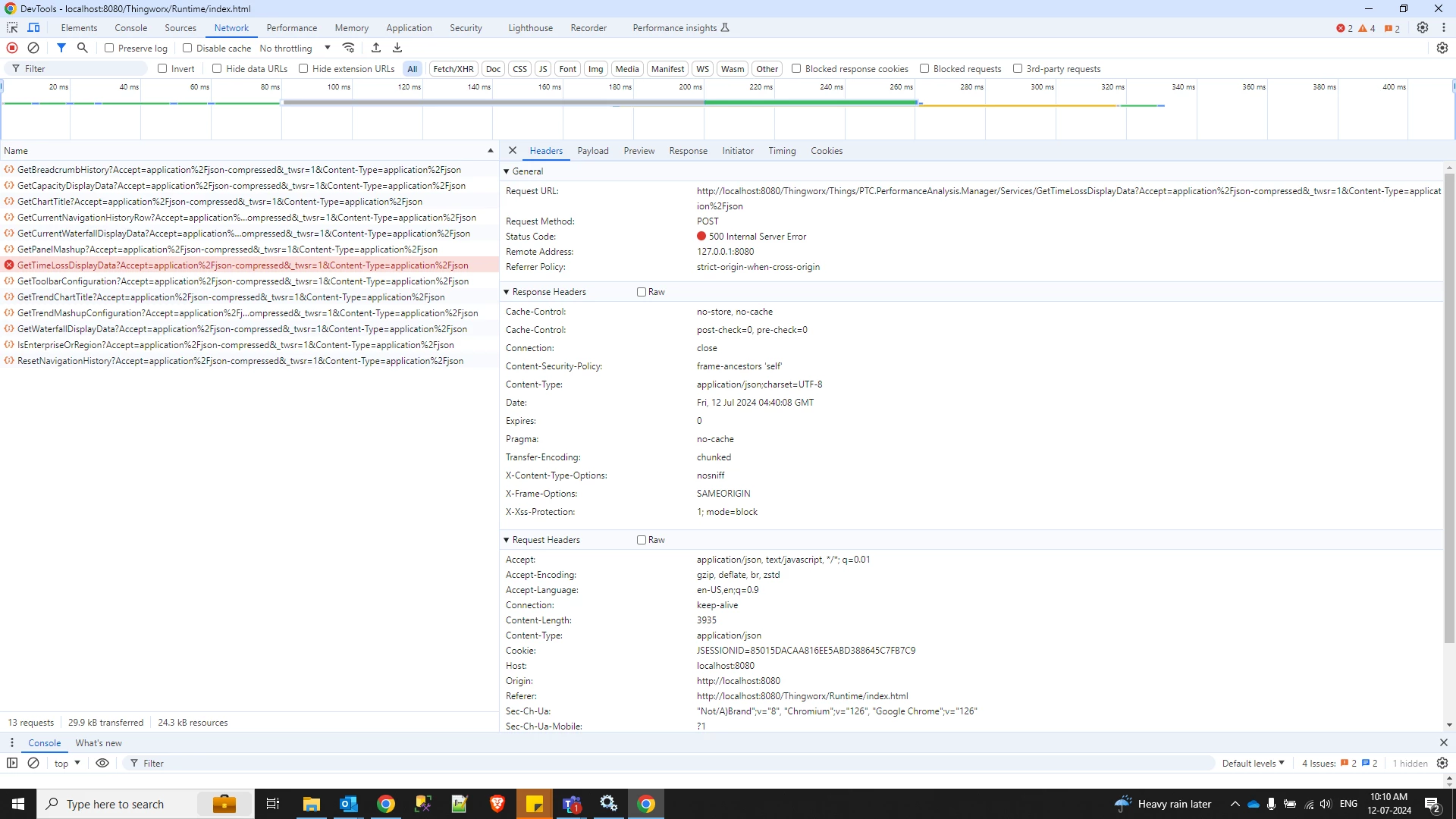

Could you attach the script log to this thread? There may be other messages that can lead to the cause. One possibility is that the collation of the database is incorrectly set. Can you check that the dpmdb is set to SQL_Latin1_General_CP1_CI_AS. Emphasis on the CI portion. That stands for Case Insensitive. If it is instead CS (case sensitive), certain database procedures will fail.

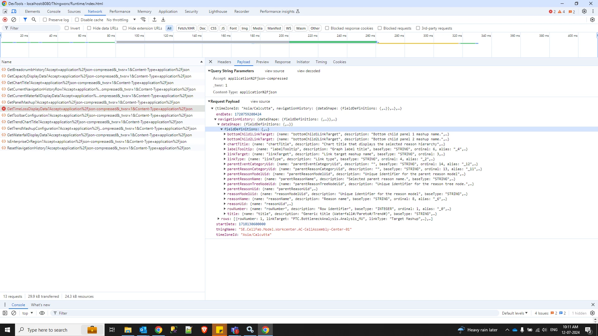

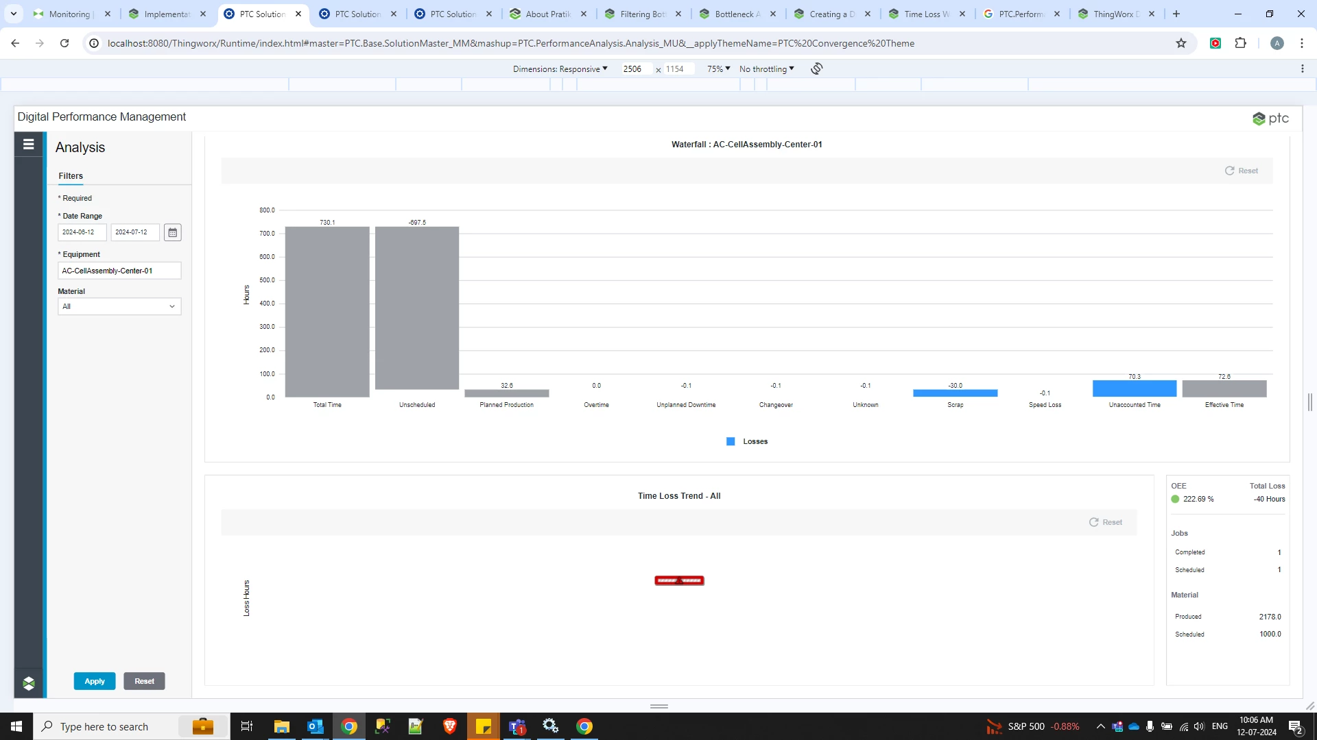

Error in: PTC.PerformanceAnalysis.Manager.GetTimeLossDisplayData javascript service. Message ::This operation failed to execute. Please contact your administrator. (GetTimeLossDisplayData#106)
Getting this in script log
