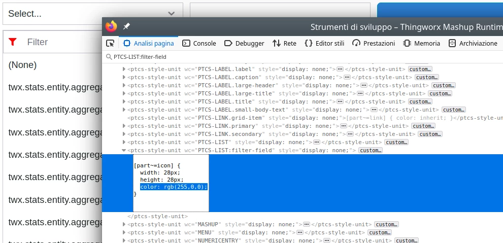

I have been struggling with setting a color on the dropdown widgets filter icon:
I found this support article that shows how to change the fonts and such for the dropdown list.
But when I try to use similar CSS to set the icon color, it doesn't work.

I was interested in your question and found a solution. I tested this in 9.3.7
/* Change the color of the filter icon for all dropdown widgets on the mashup */
ptcs-list::part(filter-field-icon) {
   color: red;
/* Change the color of the filter icon on a specific dropdown widget on the mashup */
#root_ptcsdropdown-10-external-wc::part(filter-field-icon) {
    color: purple;
Please test this and provide an update.

It looks like before 9.3 those selectors could be nested like this: ptcs-list::part(filter-field)::part(icon) {
But it's no more possible: http://support.ptc.com/help/thingworx/platform/r9/en/index.html#page/ThingWorx/Help/Mashup_Builder/Mashups/CustomCSSBreakingChangesToCustomCSSInThingWorx930.html#
As a matter of fact, the current W3C CSS spec mentions it explicitly:
> For example, x-panel::part(confirm-button)::part(label) never matches anything. This is because doing so would expose more structural information than is intended.
The official guide suggests those elements can be styled on the widget level via @supports (ptcs-style-unit: "...") [example] but this doesn't work for me in the CSS section within the mashup, so I guess it's only available if you are creating your own widget based on the out-of-the-box one.
I could find the style unit for this filter icon, but figuring out how to reach it via Mashup Builder is beyond me, sorry.

jensc17-PeridotAuthor
Mar 24, 2023 1:37 PM UTC
Hello @PEHOWE,
This works like a charm! I guess I just didn't target the correct selector.
Thank you very much.
