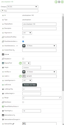

Hi all,
I have a dropdown on my Mashup that gets display data from one of my properties which have an infotable as output and Datashape of GenericStringList. It used to work fine but one day it just stops working and I can't figure out why after troubleshooting for half a day. Any help will be greatly appreciated.
Below is the settings for my dropdown widget:

It was a careless mistake on my part. Forgotten to bind the GetProperties of my Datatable to the Mashup Loaded. Thank you!
