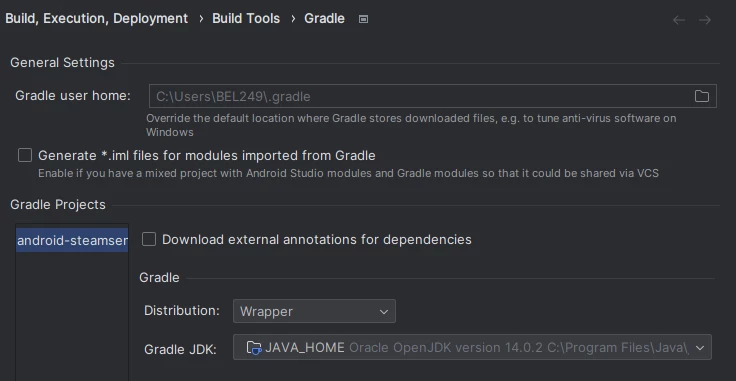

4-Configure gradle with my JDK (see pic1)

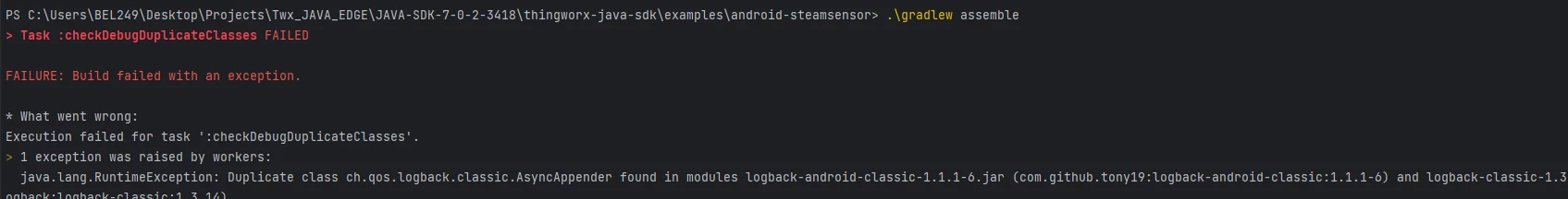

5-run  .\gradlew assemble (see pic 2)
6- Output error  (see pic 3 for full error):
 Duplicate class ch.qos.logback.core.util.StatusPrinter found in modules logback-android-core-1.1.1-6.jar (com.github.tony19:logback-android-core:1.1.1-6) and logback-core-1.3.14.jar (ch.qos.logback:logback-core:1.3.14)
 Duplicat....
