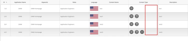

I am trying to adjust the grid column width to fit the maximum text/Icons size it contains. I want to remove the extra space from the column, as shown red box in the image below.
Currently, I have set column width to 'Auto' but it is not working.
Is there any way to do this?

Dec 2, 2024 7:55 PM UTC
Hello @SZ_10833245 ,
Setting the width of a column in a grid is a complex process.
The space allocated for the grid is divided among the display columns. The size of the titles, can make a column wider is some cases.
The UI will not leave blank space at the end of the grid. The grid will be expanded to fill the space allocated. In general the last column will be wider to fill in the space.
In some cases the space will be spread across all the columns to give an eye pleasing distribution.
Where would you have the space which is removed from the "Content Type" column added?
Pehowe
7-Bedrock
Dec 3, 2024 6:12 AM UTC
Hello @PEHOWE,
Thanks for your reply 🙂
The values in the 'Content Type' column are dynamic, meaning the number of icons it contains is not fixed. The column width shall be dynamically adapted to the maximum number of icons over all rows. The space that is removed from the 'Content Type' column can be added to the 'Description' column.

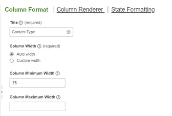

I understand that the column widths in the grid are not being set as you desire. The option you have selected "Auto-Width"  is described in the on line documentation Configuring Grid Columns
   Column Width—Sets the column width. By default, the available space is divided equally between columns.
This explains why the column you have identified is wider then you expect.
Please post if this resolves the issue.
pehowe
Dec 16, 2024 5:48 AM UTC
Instead of auto width you may try Custom Width for the particular column and allocate max possible width in px or %.
