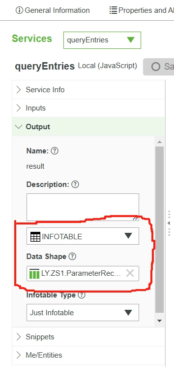

dynamic service output infotable datashape
As shown in the above figure, if I want to configure the grid in the mashup, I must set the output's datashape. If I want to implement dynamic datashape while also configuring it in the mashup, how can I achieve it through service?33.png
As shown in the above figure, if I want to configure the grid in the mashup, I must set the output's datashape. If I want to implement dynamic datashape while also configuring it in the mashup, how can I achieve it through service? think you .  my thingworx is 9.3.0

Hello @LY_10340318
As far as i can understand you want to have a dynamic datashape on the mashup, if this is the case i dont think its feasible . please refer following articles for your reference
https://www.ptc.com/en/support/article/CS330487?source=search
https://community.ptc.com/t5/ThingWorx-Developers/datashape-changing-dynamic/m-p/588040#M33377%3Fsource=search
If you have any other query apart from it please feel free to revert.

Hello @LY_10340318 ,
Please check this KB article and let us know if it helps you to achieve your use case:
Article - CS402961 - How to dynamically create temp infotable without existing Data Shape using javascript service in ThingWorx Platform

thank you,but this is not what i want.

Hey @LY_10340318 If you want to display data in grid, dynamic columns, then you can look into configuring the grid using JSON. That way you can control the grid configuration using a service, based on data you are expecting to show in the grid and you would not need to attach any datashape to the data.
