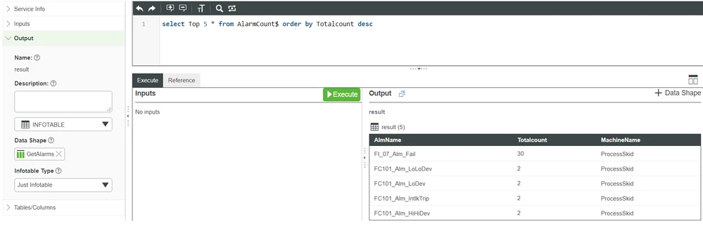

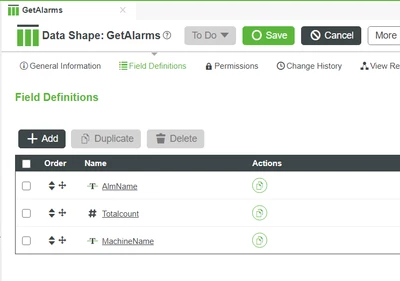

I am looking for a solution where I need to display the Data from a SQL Table(with only 3 columns) on a Label Chart, only top 5 rows(with dynamic data) needs to displayed and this table keeps on updating at every 10 minutes. I am able to display that on a  Grid Widget but can't find a solution for Label Chart Widget. Have already referred the guide from Developer Portal with this link but couldn't find the solution,as it mentions only static data from InfoTables. https://developer.thingworx.com/en/resources/guides/display-data-charts . Any inputs would be highly appreciated.
Mashup with Grid Widget & Label Chart Widget
