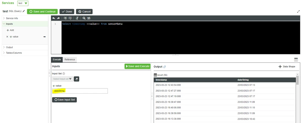

I'm trying to fetch data from PostgreSQL database.
Query,
select
 entry_timestamp + interval '30 minutes' as offset_timestamp,
 entry_timestamp
from
 sensor_data
I'm trying to pass 30 minutes from Thingworx input.
select
 entry_timestamp + interval '<dynamic>' as offset_timestamp,
 entry_timestamp
from
 sensor_data
How to do that?

Hi @Sathishkumar_C
You can try something like this. Just pass the whole '30 minutes' (with a single quote) as input to the service

Mar 24, 2023 6:27 AM UTC
Thanks @Velkumar
select
 entry_timestamp + make_interval(mins => <<offset_interval>>) as offset_timestamp,
 entry_timestamp
from
 sensor_data
Got a expected output with above code. offset_interval (Ex. 30) is passing from ThingWorx service.
Below one also working as expected,
select
 entry_timestamp + <<offset_interval>> as offset_timestamp,
 entry_timestamp
from sensor_data
offset_interval (Ex. interval '30 minutes') is passing from ThingWorx service.
