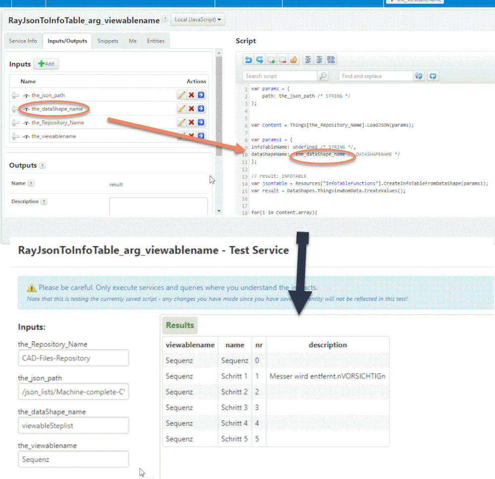

Here an example:
and here the javaScript for the service definition:
var params = {
	path: the_json_path /* STRING */
var Content = Things[the_Repository_Name].LoadJSON(params);
var params1 = {
infoTableName: undefined /* STRING */,
dataShapeName: the_dataShape_name /* DATASHAPENAME */
// result: INFOTABLE
var jsonTable = Resources["InfoTableFunctions"].CreateInfoTableFromDataShape(params1);
var result = DataShapes.ThingviewBomData.CreateValues();
for(i in Content.array){
 if((Content.array[i]).viewablename == the_viewablename)
 jsonTable.AddRow(Content.array[i]);
result = jsonTable;
