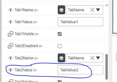

Hi @oskarberntorp
SelectedTabValue should be Tab Value not corresponding Tab Number.
You should pass TabValue from your expression
