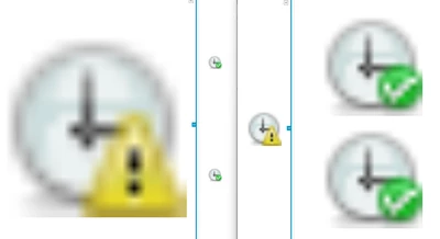

Hi everyone,
I’m working on a UI feature in ThingWorx Mashup and was wondering if something like the following is possible:

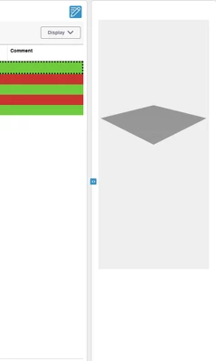

👉 I have a layout where a picture (or model view) is shown on one side, and I want to dynamically change its size based on how I drag a divider or a panel.
  • When I drag the divider to the left (making the picture area larger), the image or 3D model should grow (scale up).
  • When I drag it to the right (making the area smaller), it should shrink accordingly.
The idea is to simulate a sort of "zoom effect" by using the container resizing rather than zooming through buttons or manual controls.
📷 Here's a screenshot for visual context:
(Attached image showing the mashup and panel layout with the drag area)
Has anyone tried implementing something like this before?
  • Is it possible to bind the widget size or scaling dynamically to container resizing in ThingWorx?
  • Or is there a workaround with CSS or JS injection?
Any ideas or tips would be greatly appreciated!
Thanks in advance!

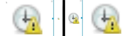

I tried a little but did not find the "perfect" solution. Attached one kinda works with collection mode "table" - to some extend. Max size is limited by "cell height", which also needs to fit the screen.
Maybe it helps.
I also found https://community.ptc.com/t5/ThingWorx-Developers/Making-a-collection-responsive/td-p/732023 which has similar question but also not the perfect solution.

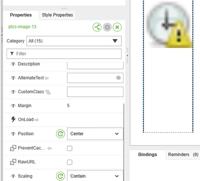

With a Image you can achieve what you want
At least this is what I think you want? Not sure if your right widget for 3d viewer supports such options (position + scaling)?

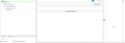

Thank you for your reply! As you can see that this is a dynamic panel and in which i have collection and these collection have images. It can be more then one images there also.

Okay. Not so sure. I did not find a bindable width property of the dynamic panel, which one could use as width for the collection tiles.
Also not sure how the tiles would resize when using the collection-widget setting 'UseMashupDimensions' and letting the mashup be responsive.
