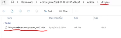

1. Download the .jar file and put it into drop-ins folder of your eclipse IDE
Now restart the Eclipse IDE, Once restarted you will see a new icon in the toolbar of your IDE,

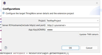

You can now use the plugin, on click of this the following download would appear,
In the dialog, select the extension project, set the server address, and add an appKey with Admin level access, don not forget to click on Update TWX details. That would store the details for future use.

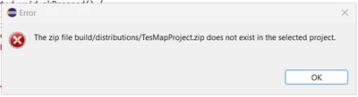

At this point make sure you have compiled your extension outside of this plugin atleast once and refreshed the project content. (Its a known bug, am working on), otherwise you will get following error,

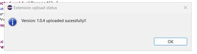

Now when you click ok, if everything goes well, you will get a successful message and the extension would be deployed to the server.
