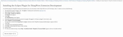

Hi everyone,
I was following the official guide for installing the Eclipse Plugin for ThingWorx Extension Development, and it refers to this link:
https://support.ptc.com/appserver/common/login/ssl/login.jsp?dest=%2Fappserver%2Fcs%2Fportal%2F&msg=1
However, when I visit the page, I don’t see any option to download the Eclipse plugin ZIP file. The instructions mention downloading it from that page, but there’s no visible download button or link.
Has the location changed or is there another way to get the plugin?
Thanks in advance for your help!

You will find Eclipse in the TWX download for the version that you are running:
https://support.ptc.com/appserver/auth/it/esd/product.jsp?prodFamily=TWX
(e.g. Release 9.6>Eclipse Plugin for ThingWorx Extensions>Most Recent Version>Version: 9-6-0>Eclipse-Plugin-9-0-1 (11 MB))
