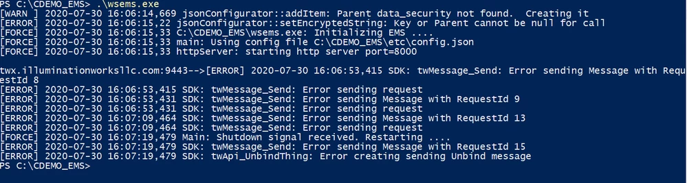

Edge Microserver not responding when inputting commands on PowerShell

Following the guide at:
 https://developer.thingworx.com/en/resources/guides/use-edge-microserver-ems-connect-thingworx/mlp-learning-path-overview
when inputting the .\wsems.exe command, it starts to initialize, but then restarts, and repeats and never actually starts a connections.  Not too sure where the error is happening but any assistance would be greatly appreciated.  Picture is attached for reference.

Hi @salzmanns.
Are you sure the port is correct in your config.json.  We probably need to take a look at that file.
