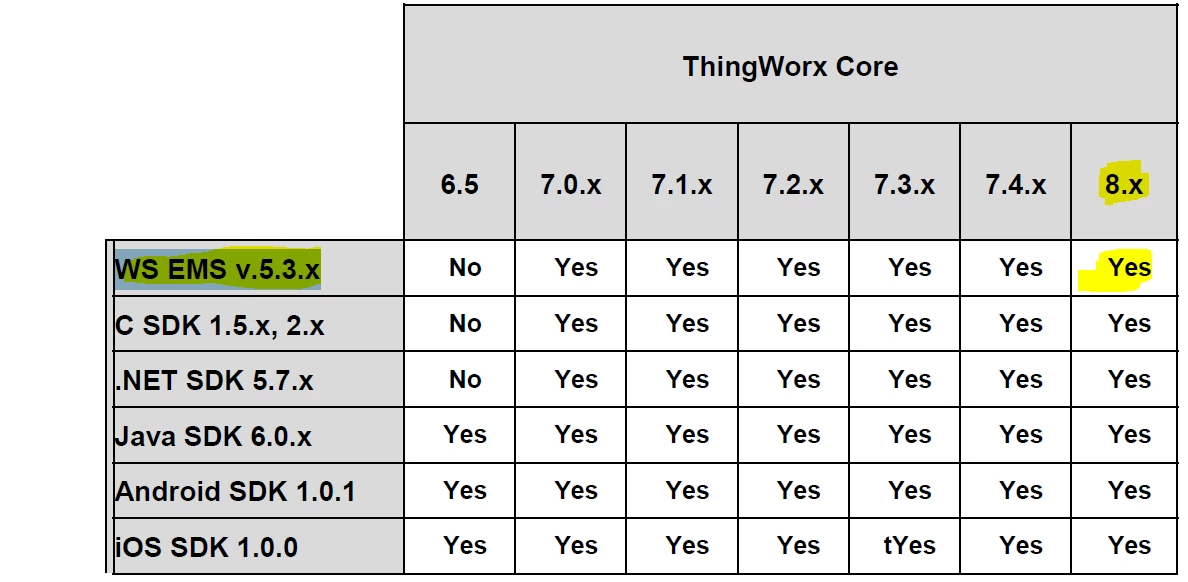

Edge System compatibilty with Thingworx 8.1
I would like to know if the Thingworx version 5.3.4.2383 is compatible with Thingworx server 8.1.
I have been trying to find the compatibility matrix document, but I have not access to the Edge System Requirements document:
https://support.ptc.com/WCMS/files/172999/en/Thingworx_Edge_Requirements_andCompatibility_Matrix_Sep...
Somebody can help me?

@slibeliumYes, it is compatible and is also mentioned on Page 5 of the document you are referring. PFA.
-Durgesh
