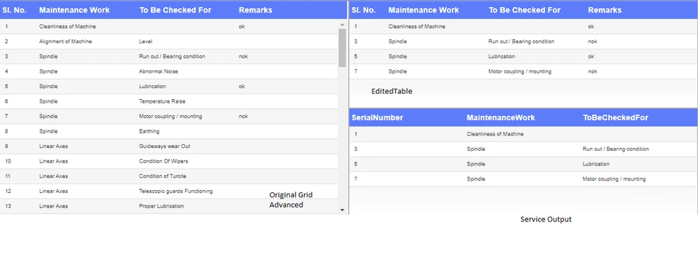

Hi all,
Grid Advanced Edited Table does not hold all the columns when passed to a service.
TWX 9.2
Thanks in advance,
Sujith

Hi @SB_9732186
Can you clarify the issue and possibly provide some screenshots?  We're not clear on the issue.  How many columns are in the table?

June 9, 2022
PFA image.
The left table is the original grid advanced, which is being edited.
The right top table is the Edited Table from the original grid.
The right bottom table is the output of the service.
Sujith

Hi @SB_9732186.
As you know, a case was opened for this issue.  It was found that the cause of the problem was the missing column in the datashape.
