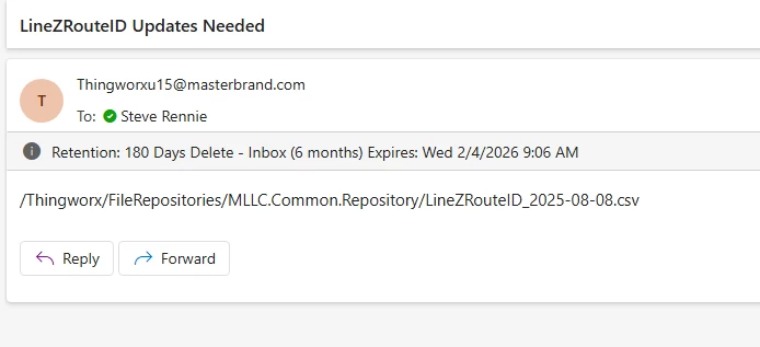

My service creates a file in a file repository.  I would then like the service to email a link to the file that the user can click on to download the file.
I've tried using the repository's GetFileListingWithLinks service that returns an infotable that has a hyperlink field named downloadLink.  However, the value that is returned is in this format:
/Thingworx/FileRepositories/MLLC.Common.Repository/LineZRouteID_2025-08-07.csv
When I email that value Outlook does not recognize that value as a link.  So, I think I need to somehow convert it to this format:
http://thingworxu15/Thingworx/FileRepositories/MLLC.Common.Repository/LineZRouteID_2025-08-07.csv

However, this is what I get - no link.
I know that I can build the link, but that would require the code to be updated with the new host as we move from Dev to Test to Production.  Something, I'd like to avoid.

The server does not know the URL itself. You have to set it somewhere manually and adapt it for each instance.
Our best practice is to create an "Environment"-Thing with a ConfigurationTable which holds different useful values like hostname, envName, sendEmails,.. These can be then used by different UseCases to get the information.
In your service you would then do a
let link = "https://"+ Things["EnvironmentThing"].GetConfigTable().hostName + fileInfo.downloadLink; // (pseudocode)
but you can also use a property or something else to store the information. (But properties may change value on extension update, so configtable is our prefference).

Hello @steve237 ,
I have looked into this issue.  The ThingWorx function "GetFileListingWithLinks" Builds the end of a URL to access a file.
The question you ask is in ThingWorx, can click on this link and it provides the requested file. When you tried to send that information in an EMail, the link is no longer complete.    When in ThingWorx the results of the function "GetFileListingWithLinks" are passed to the Tomcat instance. The Tomcat instance, then adds the protocol and FQDN.
There is no method in ThingWorx to get the Protocal and Fully Qualified Domain Name (FQDN) for the ThingWorx instance.
The only solution is to build this information from you code.
