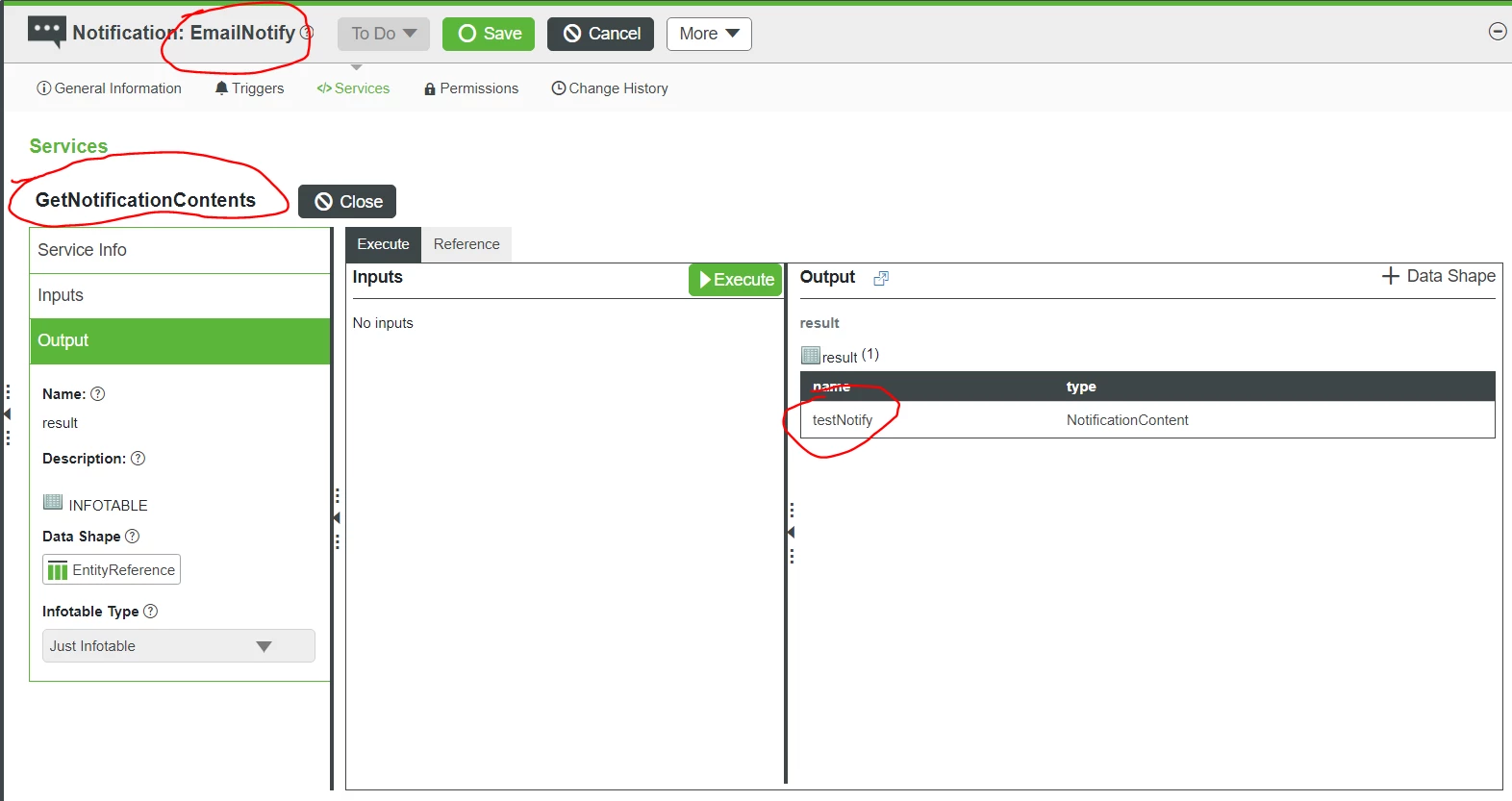

Hi experts,

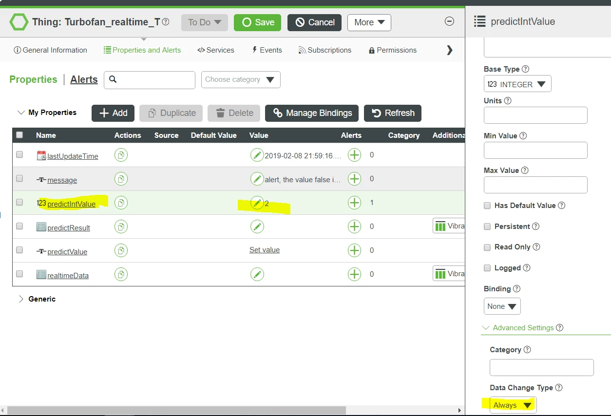

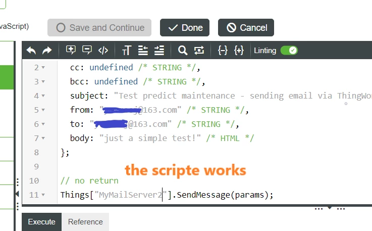

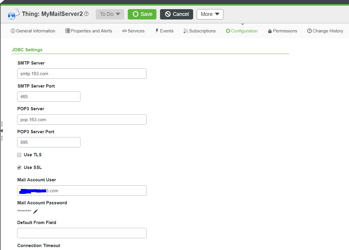

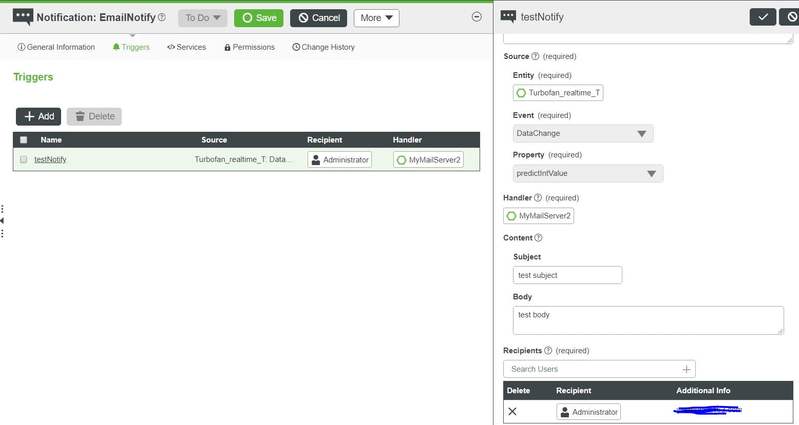

I have email extension installed. I create a thing "MyMailServer2" based on it and it works if test it with script.
However, it doesn't work when I create a entity Notification "EmailNotify" and set  "MyMailServer2" as the handler.  I have no clue about it , could you help ?
===================Updated on Feb 9==============

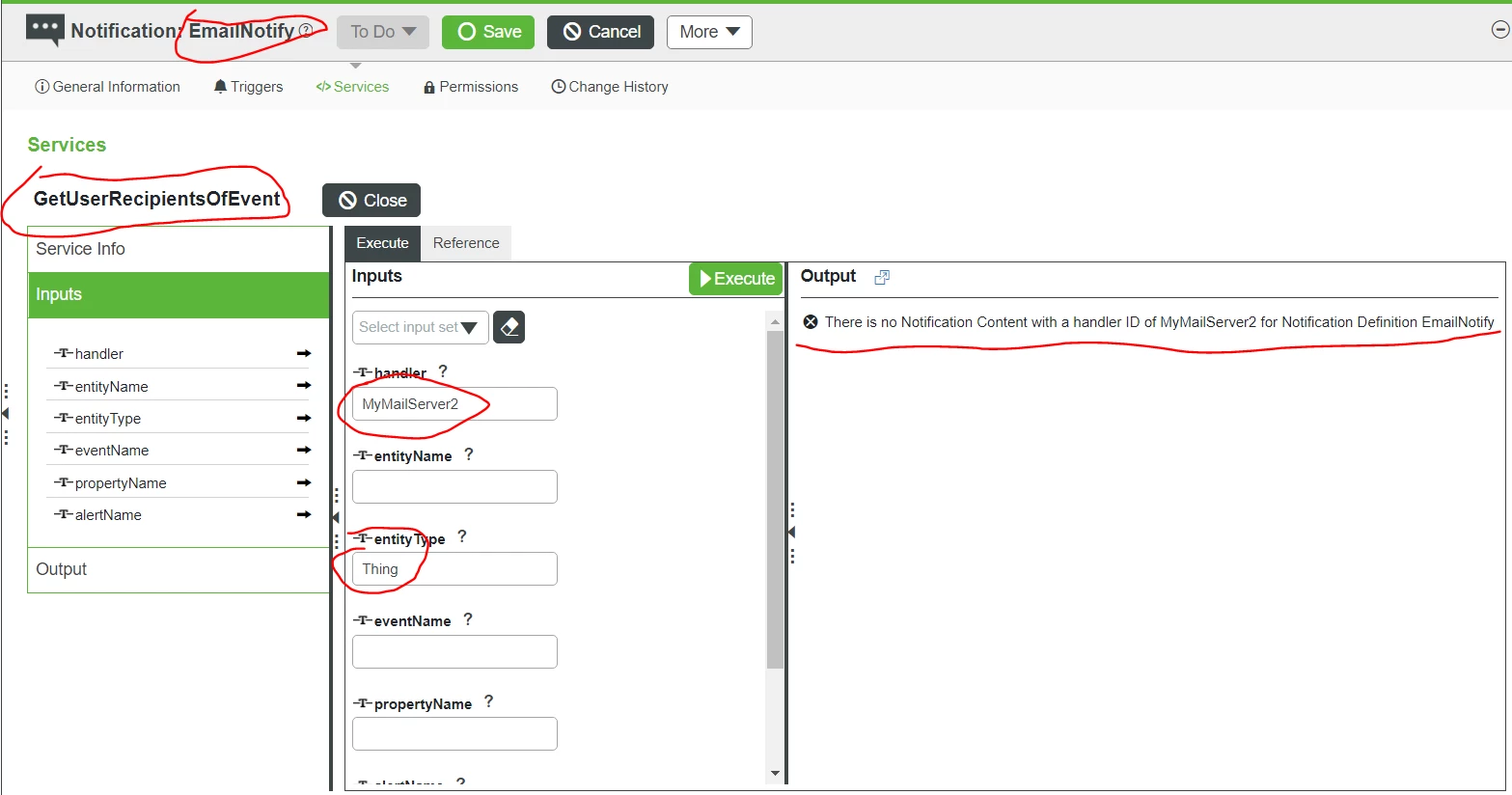

I didn't figure out the problem above , then I tried to turn to script to send email. So I need to get the recipients defined in the Notification.  I can get the notification content "testNotify" by running the service "GetNotificationContents",  While executing the service "GetUserRecipientsOfEvent" , it tells me no notification conent found(see the Capture5.PNG) .  Any idea about it ?

Are there any errors in the Application Log when the even fires the notification?
seanccc17-PeridotAuthor
Feb 9, 2019 2:36 AM UTC
No, I checked it but didn't find any error/warning log about it .
22-Sapphire I
Feb 11, 2019 8:23 PM UTC
Since you don't see any error messages, I would put some logger statements in the code, to verify that it is trying to send the email.
