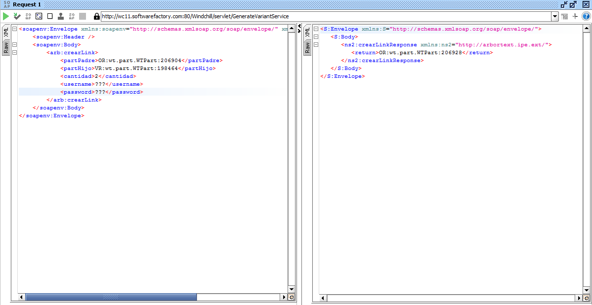

Hi. I'm using a webservice of my own where i do some operations, I've tested it with SoapUI and everything works fine. Also, I've created a service in Thingworx which make a request to the webservice I said before, the service executes  properly, but the XML of the response comes empty.
This is the structure of the XML:
<soapenv:Envelope xmlns:soapenv="http://schemas.xmlsoap.org/soap/envelope/" xmlns:arb="http://arbortext.ipe.ext/">
    <soapenv:Header />
    <soapenv:Body>
        <arb:crearLink>
            <partPadre>OR:wt.part.WTPart:206282</partPadre>
            <partHijo>VR:wt.part.WTPart:198464</partHijo>
            <cantidad>2</cantidad>
            <username>???</username>
            <password>???</password>
        </arb:crearLink>
    </soapenv:Body>
</soapenv:Envelope>
I printed the XML and this is what i get ----> <S:Envelope xmlns:S="http://schemas.xmlsoap.org/soap/envelope/" headers="">Does anyone know what could be the reason of this?
I attach an image of the response using SoapUI
Thank You for your time.

Seems like it might be related to the defect that has been previously filed and is currently backlogged, TW-9047. Since it's backlogged, it means the fix is 6 or more months out.

Hi Eddison, the problem in the jira seems to be with the xml content. It throws the content proLog error with the <listName> tag - which doesn't happen in the browser/POSTMAN because it returns the page with all the methods including GetList. It might make sense to open a support ticket at this point, and have a TSE validate the connection/investigate it further. Please let me know if you can open a support ticket , otherwise I will proceed on your behalf.
