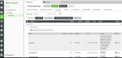

I have been following this guide(https://developer.thingworx.com/en/resources/guides/use-edge-microserver-ems-connect-thingworx/mlp-connect-ems) to establish a EMS connection with Thingworx.
after executing the wsems in cmd am not seeing either error or success message. no result is shown in cmd. However am able to see EdgeThing (Example device name as mentioned in the guide) in Thingworx and able to create a remote thing.
But when I tried to access the files using BrowseDirectory there is no data.
I am attaching my config.json file, config.lua file and log file for reference.
Somebody Please help me to resolve this
August 16, 2021
Hi Sruthi, try set the log level to INFO and see the result.
ex:"level":  "INFO",
