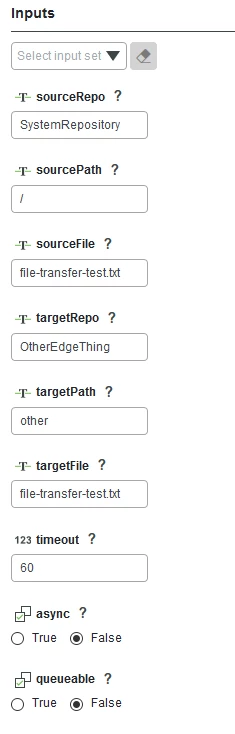

I try to send a small simple txt-file from SystemRepositoy to the "other"-folder on the edge device via the copy-service of the FileTransferSubsystem.
After the timeout-time ends I get a result table with not much information what went wrong. In Application Log i get this:
[context: Error occurred during transfer.: service execution failure resultCode=STATUS_GATEWAY_TIMEOUT: job=TransferJob [tid: adf44aaa-df36-463d-88d3-3f5d1d066e62, sourceRepo: SystemRepository, sourcePath: /file-transfer-test.txt, targetRepo: OtherEdgeThing, targetPath: other/file-transfer-test.txt, partPath: __staging__/OtherEdgeThingother.file-transfer-test.txt.part, sourceChecksum: , targetChecksum: , state: ACTIVE, code: 202, message: Transfer request accepted, isAsync: false, isRestartEnabled: true, isComplete: false, bytesTransferred: 0, blockcount: 0, blocksize: 8192, size: 35, maxsize: 100000000, transferTime: 0, transferControl: platform, reservationId: , user: david.richter, isQueueable: false, enqueueTime: 0, enqueueCount: 0, metadata: null, Job [id: adf44aaa-df36-463d-88d3-3f5d1d066e62, lastTouch: 1574415465008, timeout: 30000, TimedLock [createTime: 1574415464898, signalTime: 0, duration: 0, signaled: false]]]]
This says the transfer request was accepted (202) but no data was transfered.
On my edge device a I have a new created .part file (OtherEdgeThingother.file-transfer-test.txt.part) with size of zero.

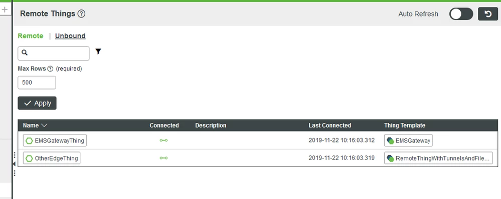

I have no idea what went wrong. Both devices (EMSGatewayThing and the OtherEdgeThing) are connected under remote things
