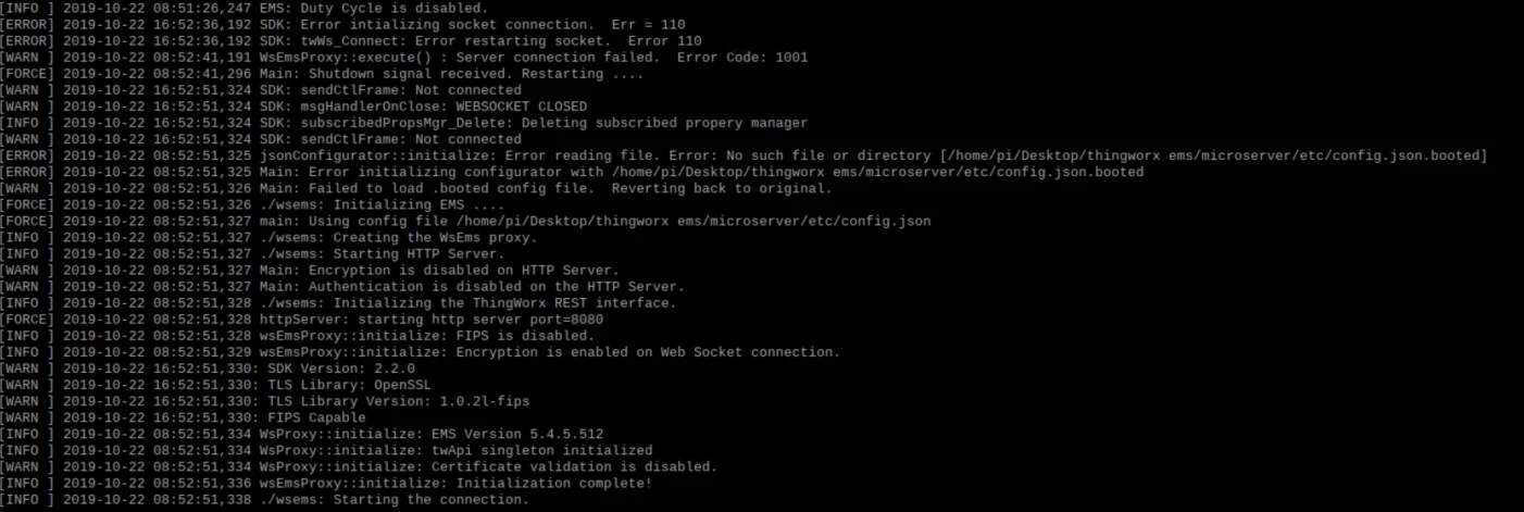

Can you upload more of the log file along with your config.json file
hujingrui1-VisitorAuthor
October 23, 2019
I am starting to think it might be a subsystem issue. I cannot access or http://123.123.123.31:443/Thingworx/WS even http://123.123.123.31:443/Thingworx/WS on browser.
Is there a place in thingworx composer where i can find this information?
Previously i have similiar issue for anomaly detection: http://123.123.123.31:8091/training but that issue is solved but seems to be down again now. Are the microservices running together backend? ie all services either run or stops together. if so, it might be the issue.

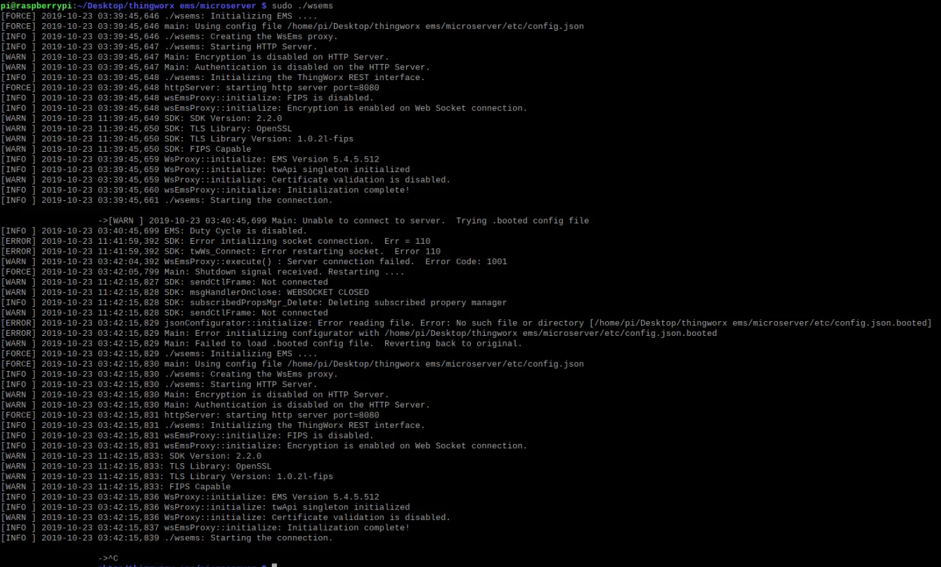

October 23, 2019
log file is as follows.
error is as attached
"ws_servers": [{
"host": "123.123.123.31",
"port": 443
"appKey": "xxxxxxxxxx......",
"http_server" : {
"host": "127.0.0.1",
"port": 8080,
"use_default_certificate" : true,
"ssl" : false,
"authenticate" : false
"logger":{
"level":"INFO"
"certificates":{
"validate": false
