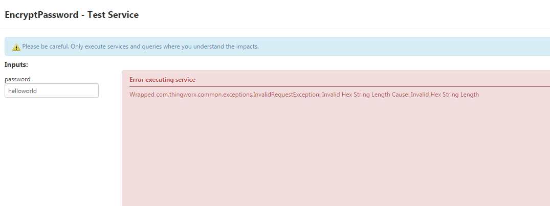

hi,
  i am facing the Invalid Hex String length while executing  EncryptWithKey service.
var key = "327235753778214125442A472D4B6150645367566B59703373367639792F423F4528482B4D6251655468576D5A7134743777217A25432646294A404E63526655";
var params = {
  data: password /* STRING */,
  key: key /* STRING */
// result: STRING
var result = Resources["EncryptionServices"].EncryptWithKey(params);

There is a Jira for improvement of this functionality, PSPT-3136.
Currently, details on our encryption:
  • Algorithm used is based on SunJCE, AES/CBC/PKCS5Padding, 128 bit
  • Key size must be specified in 56 bytes via a hex string
  • IV will always be the first 16 bytes of the key specified for encryption / decryption
