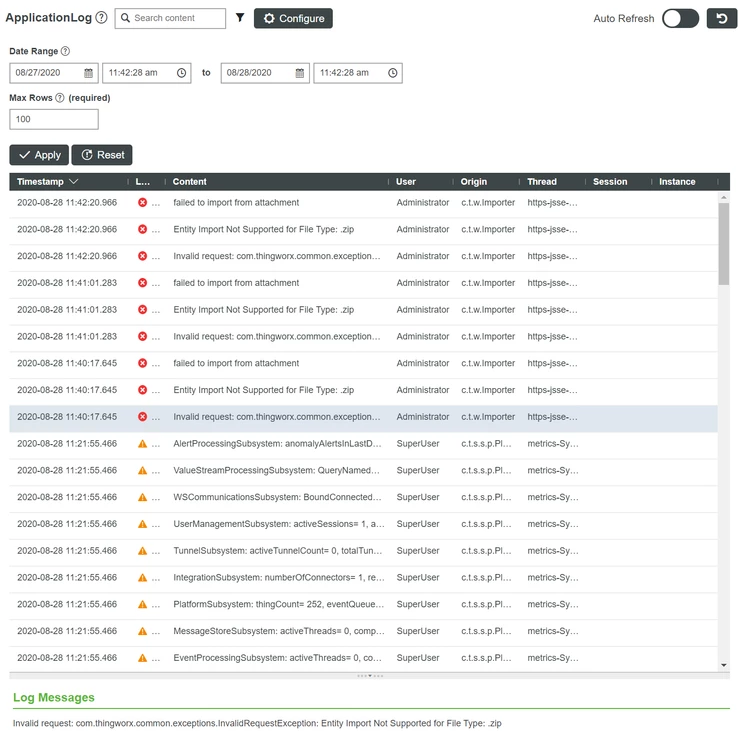

"Entity Import Not Supported for File Type: .zip" when trying to import an extension
Hello everyone,
I am trying to import an extension, and I keep getting the error I wrote down in the Subject:
this happens with any extension, also the one build in this tutorial. The only thing I have done differently is the Gradle build, which I carried out via Command Prompt, but the error shows up also if I use the pre-built .zip file in the tutorial files.

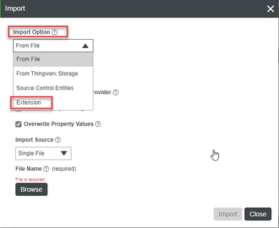

    Are you importing this specifically as extension import or just "file import"? Please make sure to use "Extension Import" .

    jman8715-MoonstoneAnswer
    August 30, 2020
    Best Wishes!
    Teresa
    Raccone1-VisitorAuthor
    August 31, 2020
    Hi @jman87 ,
    This definitely was the issue, the thing being that I got confused by the second window, erroneously selecting "From File" because I thought it meant "Import extension from file".
    Thanks for the help,
    Federico

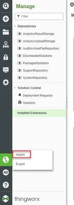

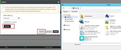

    Rocket_Max
    August 31, 2020
    Hello @Raccone
    follow this steps:
    BR,
    Max
