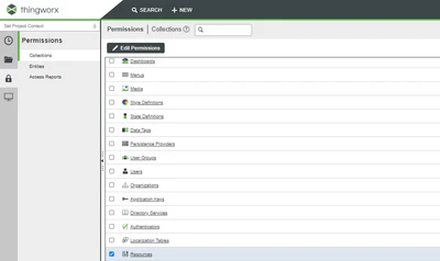

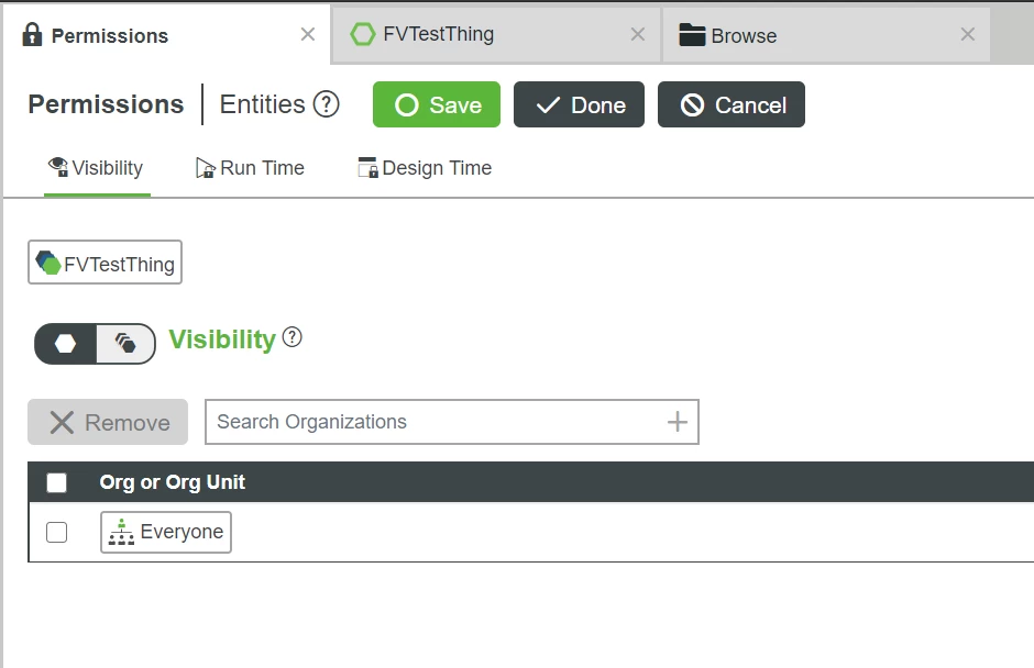

    You are giving visibility permissions for entities such as things, templates etc. But the functions and entity services lies under resources as mentioned earlier. You have to give permissions to resources.
    August 28, 2020
    All Entity services, Sessions services and all functions existed under resources. You can just go to resources and provide visibility permissions to default organization existed in the system which is 'everyone' or you can create a new organization and provide visibility permission for you organization.

    Hello @abhiramk,
    Thanks for your answer, I have provided visibility permission like this (FVTestThing is the Thing Template I am trying to instantiate):
    permVis.PNGBut this is not doing it for me. Am I missing something?
