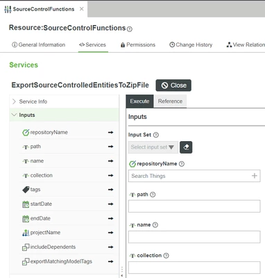

We think we have narrowed it down to some bug in the export and zip functionality of Thingworx:
What we found is that the following service also has the exact same issue (so perhaps same code is used for the export to zip file in the export function).
For now, the workaround will be to first export the project to a repository and from there zip it manually using the CreateZipArchive on any repository:
And then downloading the zipped file manually.

Hello Community,
Jens
