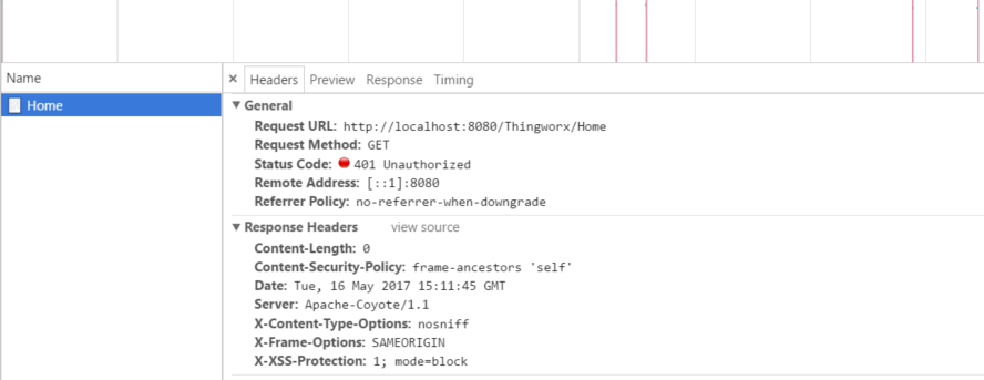

Erorr in Thingworx 7.4 installation
Hi i followed the guide of MS SQL installation.
Tomcat start correctly,
but Thingworx not started.
Here my thingworx log :
2017-05-16 16:18:10.199+0200 [L: ERROR] [O: c.t.s.ThingWorxServer] [I: ] [U: SuperUser] [S: ] [T: localhost-startStop-1] [message: Connections could not be acquired from the underlying database!]
2017-05-16 16:18:10.216+0200 [L: INFO] [O: c.t.p.p.PersistenceProvider] [I: ] [U: SuperUser] [S: ] [T: localhost-startStop-1] Connection ThingworxPersistenceProvider, type MssqlPersistenceProviderPackage stopped
2017-05-16 16:18:10.217+0200 [L: WARN] [O: c.t.p.p.PersistenceProvider] [I: ] [U: SuperUser] [S: ] [T: localhost-startStop-1] Could not find persistenceProviderPackage MssqlPersistenceProviderPackage and thus could not stop data processing
2017-05-16 16:18:10.222+0200 [L: ERROR] [O: c.t.s.ThingWorxBootstrapper] [I: ] [U: SuperUser] [S: ] [T: localhost-startStop-1] [message: Unable to initialize and start system: Connections could not be acquired from the underlying database!]
2017-05-16 16:18:10.222+0200 [L: ERROR] [O: c.t.s.ThingWorxBootstrapper] [I: ] [U: SuperUser] [S: ] [T: localhost-startStop-1] *** Web Application STATE is being set to ERROR! ***
2017-05-16 16:18:29.798+0200 [L: ERROR] [O: c.t.s.a.AuthenticationFilter] [I: ] [U: ] [S: ] [T: http-nio-8080-exec-5] Could not handle request
2017-05-16 16:19:18.410+0200 [L: ERROR] [O: c.t.s.a.AuthenticationFilter] [I: ] [U: ] [S: ] [T: http-nio-8080-exec-9] Could not handle request
2017-05-16 16:19:29.454+0200 [L: ERROR] [O: c.t.s.a.AuthenticationFilter] [I: ] [U: ] [S: ] [T: http-nio-8080-exec-7] Could not handle request
2017-05-16 16:23:24.514+0200 [L: ERROR] [O: c.t.s.a.AuthenticationFilter] [I: ] [U: ] [S: ] [T: http-nio-8080-exec-2] Could not handle request
2017-05-16 16:23:57.938+0200 [L: ERROR] [O: c.t.s.a.AuthenticationFilter] [I: ] [U: ] [S: ] [T: http-nio-8080-exec-7] Could not handle request

any suggestion?
20-Turquoise
May 16, 2017
Have you ran the ms sql db setup and schema setup scripts?
please check this post
Troubleshooting MS SQL connection to Thingworx 7.4 in Windows
and also this Thingworx 7.4 MSSQL Install Errors
