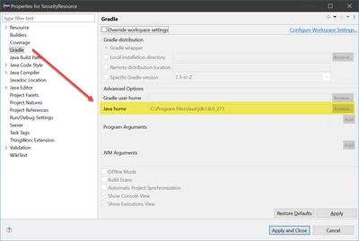

Oct 25, 2021 9:52 AM UTC
Maybe verify that the Gradle Java home is pointing to a Java SDK.
