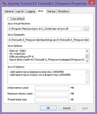

ERROR com.thingworx.security.SecurityManagerBootstrapper - Failed to create SecurityManager
Error message ::" ERROR com.thingworx.security.SecurityManagerBootstrapper - Failed to create SecurityManager, Failed to load SecretProvider
 ERROR ErrorLog.com.thingworx.security.authentication.HAAuthenticationFilter - Failed to initialize HA Authentication
com.thingworx.exceptions.ConfigurationException: java.lang.RuntimeException: Failed to create SecurityManager, Failed to load SecretProvider "
I have tried to install Thingworx8.4 with Postgres.These are folder and created in D drive and give full control to system and users.
Kindly help me to resolve this issue.

Can you please check this support article for this particular issue - https://www.ptc.com/en/support/article/CS305796
Let us know if performing the steps mentioned in the above article helps .
