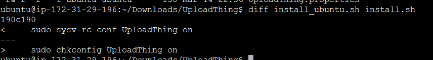

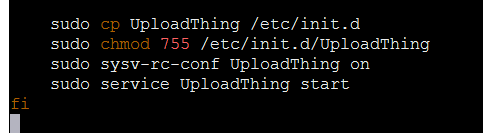

First, the install.sh has to be modified at the end. The way for Ubuntu is (line 190)
Make a copy of the install.sh file, name it as install_ubuntu.sh
need to make sure you have susv-rc-conf installed in ubuntu.
There a screenshot of the Diff

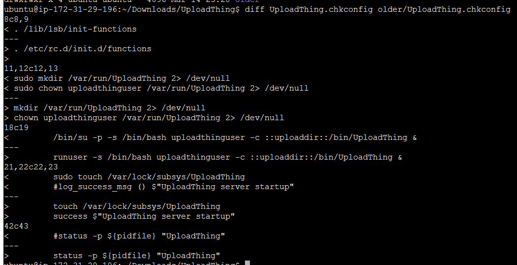

Second, the file UploadThing.chkconfig file.
Line 9
. /lib/lsb/init-functions
Line 12,13
sudo mkdir /var/run/UploadThing 2> /dev/null
sudo chown uploadthinguser /var/run/UploadThing 2> /dev/null
Line 19
/bin/su -p -s /bin/bash uploadthinguser -c ::uploaddir::/bin/UploadThing &
Line 22,23 (i just commented the line 23 for now.)
sudo touch /var/lock/subsys/UploadThing
#success $"UploadThing server startup"
Line 42 (comment this line for now)
#status -p ${pidfile} "UploadThing"
Here a diff screenshot. The < represents the Ubuntu modified file.

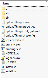

Hi Keiner;
Thanks for your effort in exploring this workaround.
However, I do not have the mentioned file "UploadThing.chkconfig" available.
These are the files that I have available extracted from UploadThing_Install-52-2.zip
How did you get the "UploadThing.chkconfig" file?

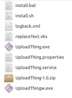

March 15, 2017
Hi Tom,
we certainly have different versions. I did got that from the PTC Software Download site this week.
The revision I have is the following
Inside that, you can find the UploadThing_Install-52-2.zip. Which has the following content.
