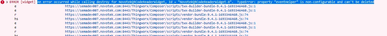

I am developing a widget snd I get the bellow error, as I can´t find an obvious explination, I wonder if anyone here knows what it means:
An error occurred while calling destroy for NovotekQRCodeReaderWidget, Id = "NovotekQRCodeReaderWidget-8". TypeError: property "eventHelper" is non-configurable and can't be deleted

Since you are having issues with all mashups, it sounds like you have introduced a library that is conflicting with the ones that come with ThingWorx.  You can test this by removing your extension and then check the mashups that aren't configured to use your custom widget, to see if you're still getting errors.
Note:  if you try to test your mashup that contains your custom widget after you remove the extension, the mashup builder will remove it from the mashup, so you may want to make a copy of the mashup before doing any further changes or testing on it.

Just to clarify, you're creating a widget extension?  At what point do you get the error?

Yes, I build a widget extension.
When I load the mashup builder.
Now, I also get this error when running the mashup, from what I can see, the file the error referes to looks good.
Uncaught SyntaxError: Unexpected end of input (at CombinedExtensions.20231113_155851.js:24462:1)

So you were able to import the extension without issue?  Are you getting the error with any mashup or just the one that uses the extension?
