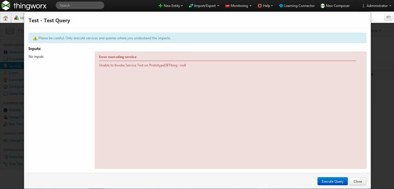

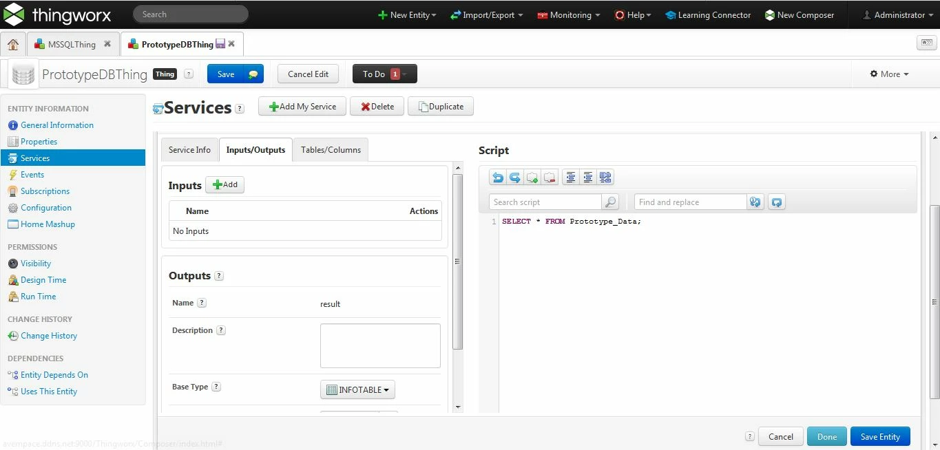

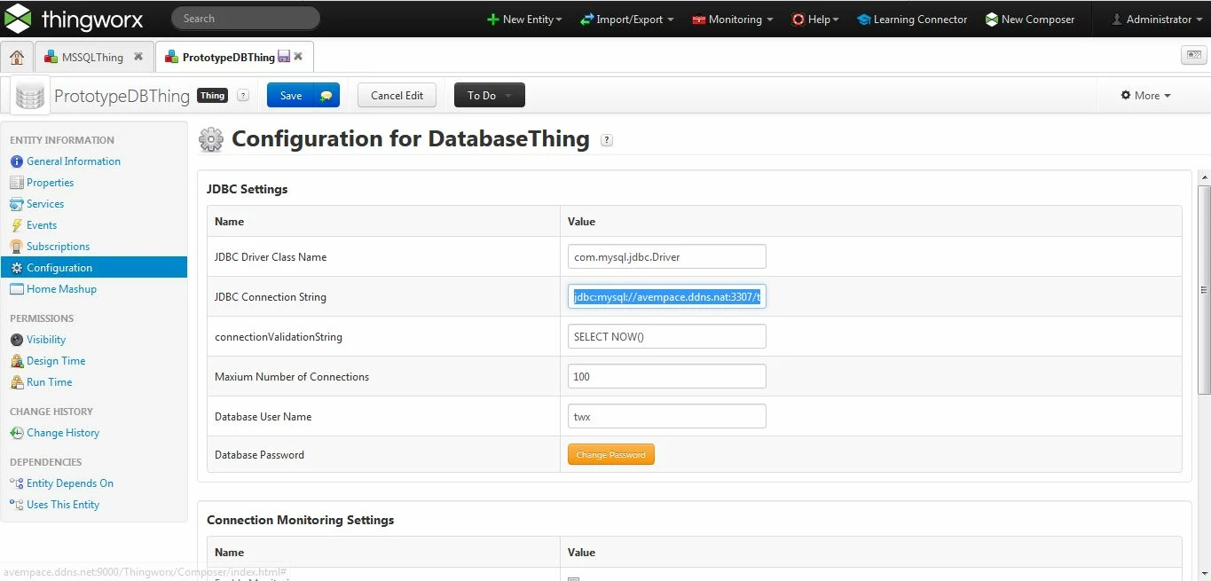

I am trying to connect Thingworx to MySQL Database to store and read data but it doesn't seem to connect to it. I am constantly getting the error message "Unable to Invoke Service <Service> on <ThingName> : null" when running a simple service to query available data on the database. The isConnected property on my thing is always False, i used MySQLThingTemplate for the Thing.
I created a new user and have granted it all the permissions on the database server and i can access it from another device.
here is a screenshot of the setup.

Hi @csadouq do I understand it right that you have this issue even with the Administrator user for Thingworx? Have you checked if the MySQL server is reachable from the machine where you ThingWorx is installed, or are they both on same machine?
csadouq1-VisitorAuthor
They are both on the same machine, and i am using the local network address to avoid problems, i tried accessing to it from another machine and it worked but it doesn't seem to work from Thingworx
Thanks for adding more info, could you please also let me know what template your Thing is based of? Would it be possible to share screenshot?
