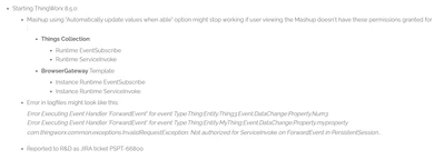

Error Executing Event Handler 'ForwardEvent' for event Type.Thing:Entity.MyThing:Event.DataChange:Property.myproperty
Then I found the following article, it is in the same situation. But I am using the mashup of the administrator user view, and this problem still occurs. Is there any temporary solution? Thank you
https://www.ptc.com/en/support/article/CS243895?&language=en&posno=1&q=ForwardEvent&source=search

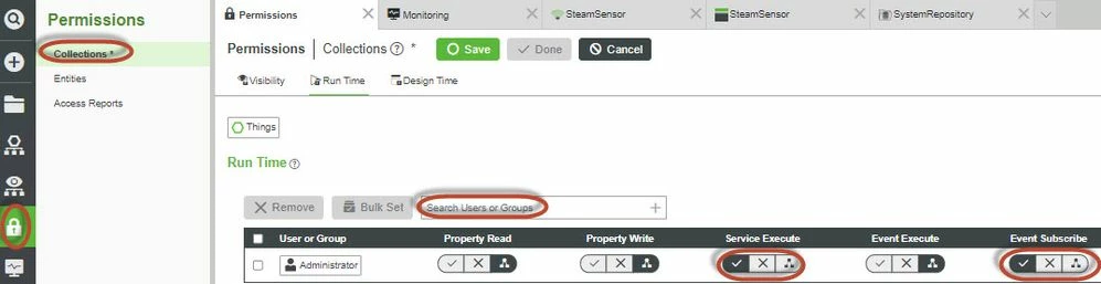

Can you try to grant these permissions manually for your Administrator user?
1. Permissions > Collection > Things > Runtime,  add your account and grant Service Execute && Event Subscribe

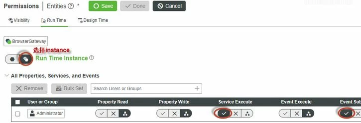

2. Look for BrowserGateway,Visit permission > Runtime > instances, add your account and grant Service Execute && Event Subscribe

June 3, 2021
@yhan
I followed the above steps and restarted tomcat, but the error log still exists, Is there any other solution? Thank you!
