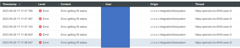

Hi all,
When I try to access the Mashup Runtime using a non-administrator account, I get the below error message
I tried following the article
Article - CS289125 - Error getting IR status in Application logs when non-admin users try to access Thingworx Mashups during runtime (ptc.com)
Setting Permissions for Integration Connector Activities (ptc.com)
Still, I'm getting an error
Could someone help me with this
Thanks in advance
/VR
VelkumarAnswer
Oct 5, 2023 8:48 AM UTC
After providing permission to users in Run Time Instance instead of Run Time only it starts to work.
