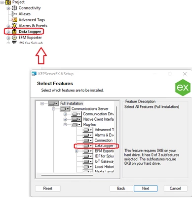

Had to to a reinstall of Kepware V6.12.361.0. I had exported the current project to a .json file, but when I try to import it there's an error "Failed to parse JSON document at line xxx: Unrecognized property."
The line is ""datalogger.LOG_GROUP_ENABLED": false,"
I'm still pretty green with Kepware but this sure looks like a legit entry to me. Any ideas?
Thanks. Mike.
November 10, 2022
Can you check if Datalogger is installed on the Kepware server where you imported the json file ?
if not installed, you need to rerun installer and check Plug-ins > Data Logger option.
if installed, please upload your json file so we can test locally.
