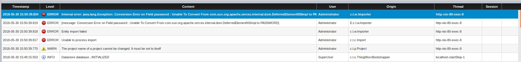

Hi, After installing ThingWorx 8.2.5-b260 I started the "Introduction to ThingWorx 8" course. In "part 1" there is an exercise for importing external contents from the course materials. When I try to import the xml entities I get the error "Error importing: error, Not Acceptable". In the attachment is my application log. Can someone help? TY

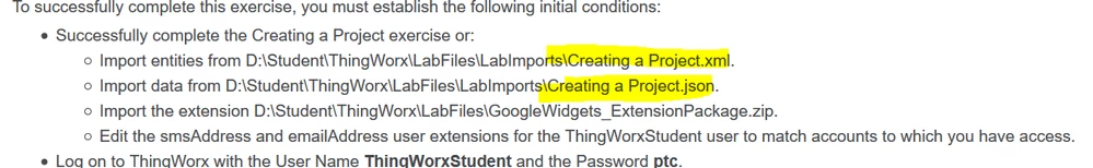

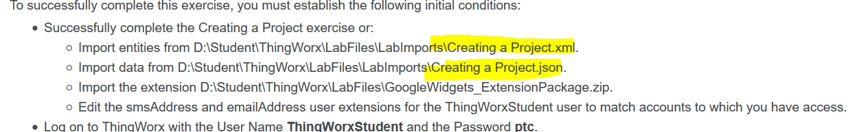

You need to unzip the downloaded Lab files and import json and xml seperately.

I've tried your solution and I get the same error when importing the "Creating a Project.xml". As for the widgets, they were already installed.
