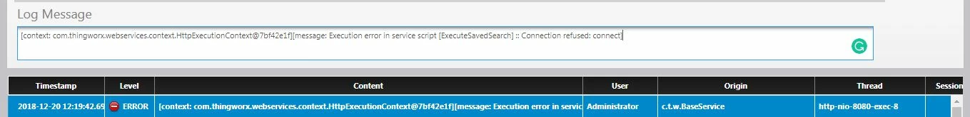

but when I create my own mashup I get the error like:
[context: com.thingworx.webservices.context.HttpExecutionContext@7bf42e1f][message: Execution error in service script [ExecuteSavedSearch] :: Connection refused: connect]
Also, windchill is not installed on my system, it's on another system, but in the same network.
Service from "ptc-windchill-demo-thing"      getRestUrl services gives output as:
                                                                http://localhost:7080/Windchill/servlet/rest

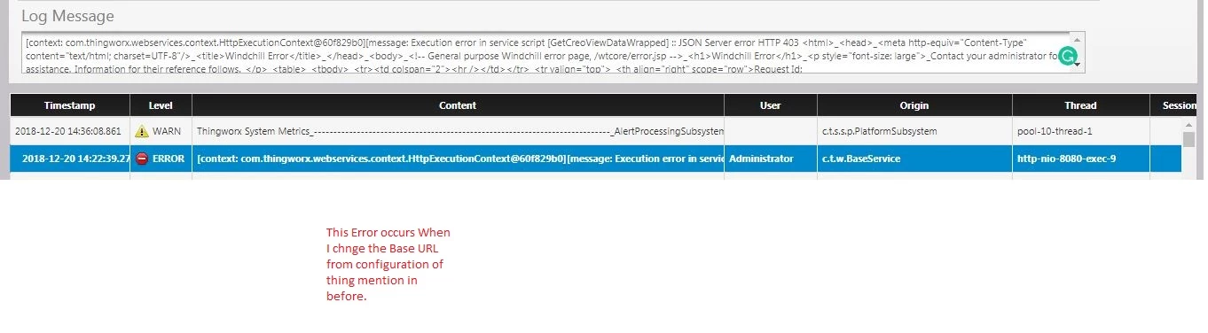

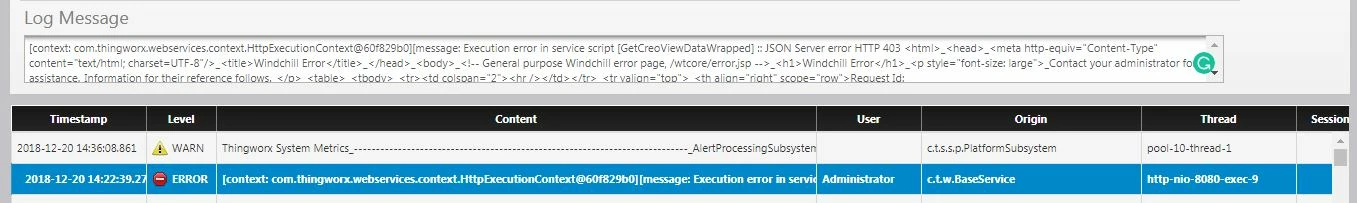

 Also when I changed Base URL to as: http://gt036.galaxy.com/Windchill
and then execute my mashup, then I get an error as'
 as mention in image 2
what must be the problem?

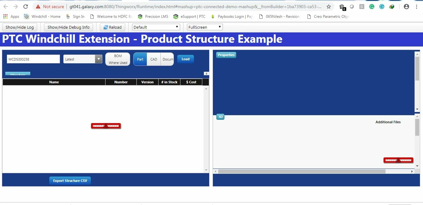

I have installed Navigate 1.8 installer(.exe). I have configured Fixed Authentication for Windchill 11.1 M010.  M Navigate i.e LandingPageAccessAppMashup is working fine.  In the composer, I have some already created mashups (may be at the time of installation), So I am trying to view that mashup(ptc-connected-demo-mashup).  When I entered the part number it shows some error symbol.
Also
"ptc-connected-demo-mashup" uses data of  "ptc-windchill-demo-thing".
In Configuration of ptc-windchill-demo-thing, Base URL was "http://localhost:7080/Windchill"
The error I get when The view that mashup and enter the Part number is: "Connection Refused: connect"

when I change the Base URL, I get the error as:  Windchill error,
Is it a trusthost problem with windchill?

We need more details here. What do you have installed? Where are you getting that mashup from - is it a demo, training material, extension? What are you adding/how are you creating your own mashup?
shindemayur1-VisitorAuthorAnswer
