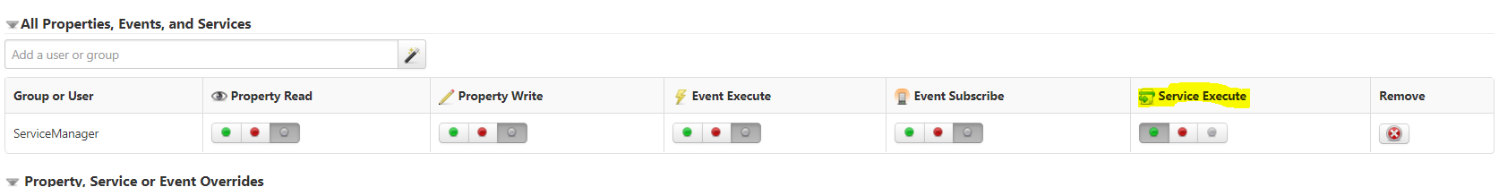

Hi Domenic Zens,
Could you please review if the user has the Service Execute permission on the Run time instance (Green dot should be selected for the Service Execute option) as shown below:
