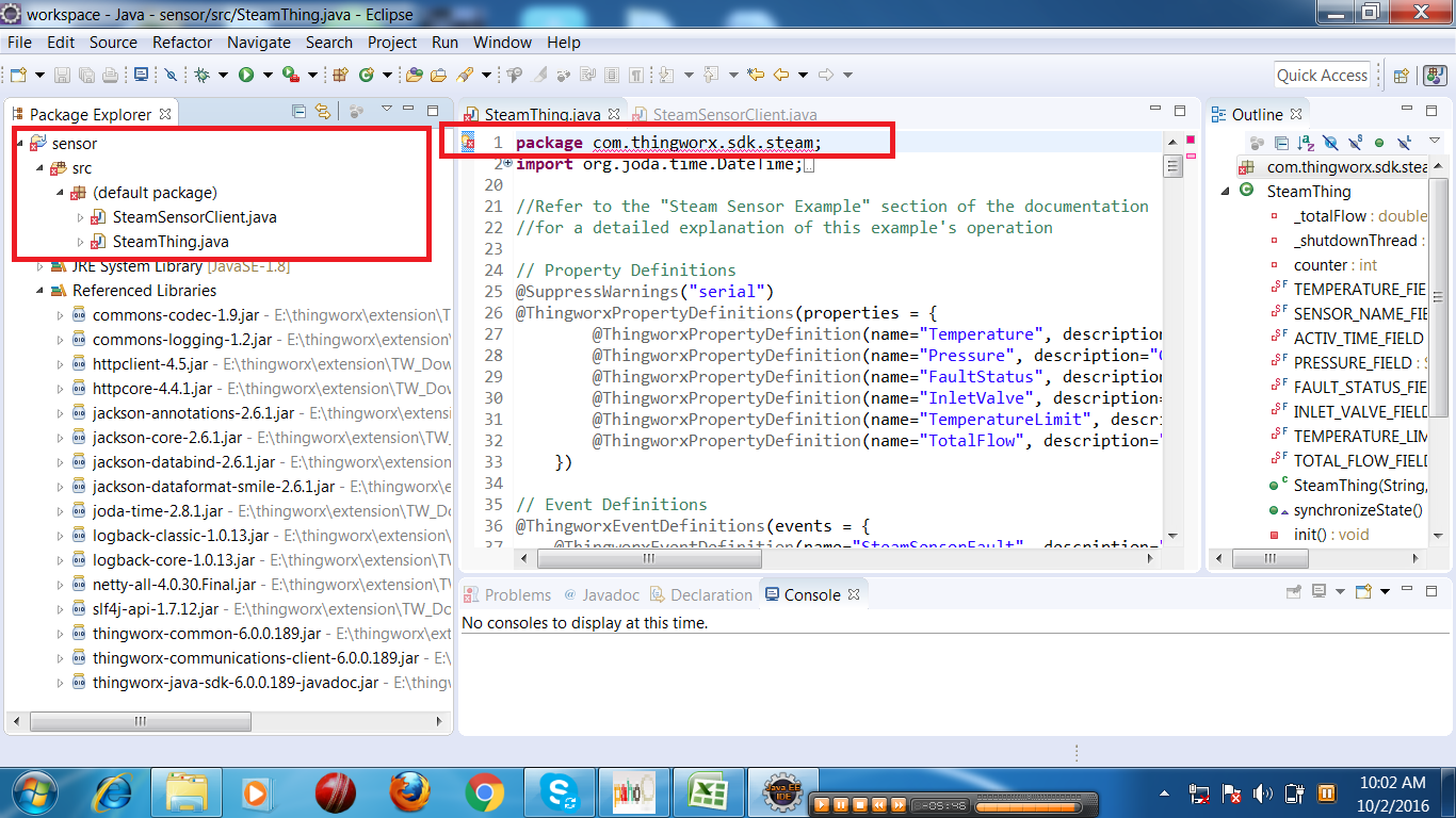

In java sdk, the package was not supported i attached the error in javajavasdk.png

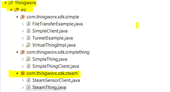

You have to make the same Package structure as mentioned in class.
For Example , SteamThing.java class is in Default package.
Make another package structure inside source as com>Thingworx.sdk.steam.
There are other way to get rid of such small compile time errors , The one above is simplest to get make it work.
